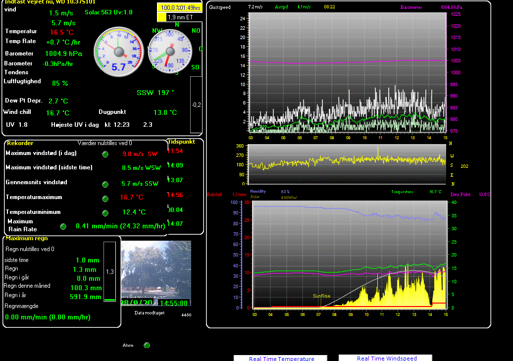

Not sure if anyone else is having this problem… but I ever since I got the newest version today I have been flat lining ever hour for about 3 hours and then it will fix itself on its own, then it will just happen again and again. Restarted the program, restarted the computer. Not sure if its the newest version that is causing this. Maybe Brian can look into it? See attached!

http://www.vejr.arloese.dk/20110321.gif
