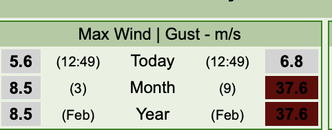

Sadly my Davis station recorded some faulty wind data, witch let me back with a faulty wind gust record.
As I understand the data is delivered by WU if history is set WU. Is there no way to correct or delete this data? I’ve corrected the bad data in Meteobridge, but it doesn’t solve my problem.

Explained here: No High/Lows, where is history and graphs data used for, and ? cron ?
WU by definition old data (2-6 hours old) => Graphs => do not need near realtime
live-data => cron-jobs => History => max 5 minutes old
Your screenshot => high-lows are store in history.txt
Clean those values pwsWD/PWS_hist_update.php?pw=12345
Thanks Wim - just was I needed, and I’m glad the solution was simple :slight_smile:
