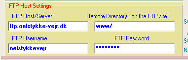

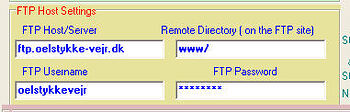

I have changed my WEB-hotel provider, and the new one gives me the path www/, in stead of the normal / - this means probably that somewhere in the system I am using wrong adresses, but there are so many places to change, and I do not seem to get it right.
Help
in the control panel, ftp/internet setup, connections, is the main FTP settings you need to set
set their the correct remote directory name

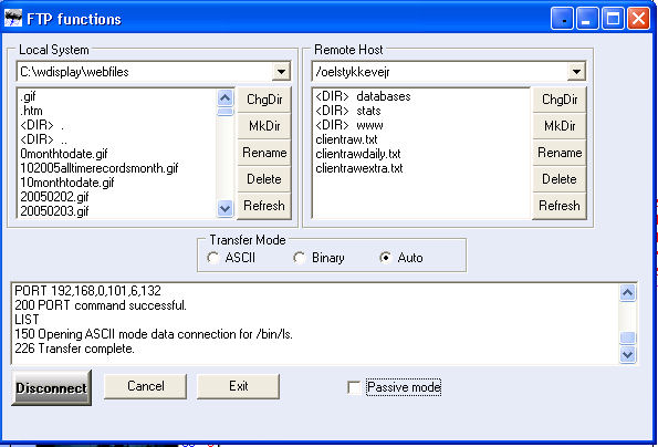

It looks like the FTP does not get the correct connection, look at the two images:
Somehow the WEB hotel provider have my path as oelstykkevejr/
And things to put in for the web must be in the WWW directory, but I do not get in tuch with that.

Remote directory on the FTP site does not appear correct to me… I would think, and for my host it would be “/www” not “www/”
try just www :wink:
Brian,
Setup just before my last post was www/, nothing worked.
