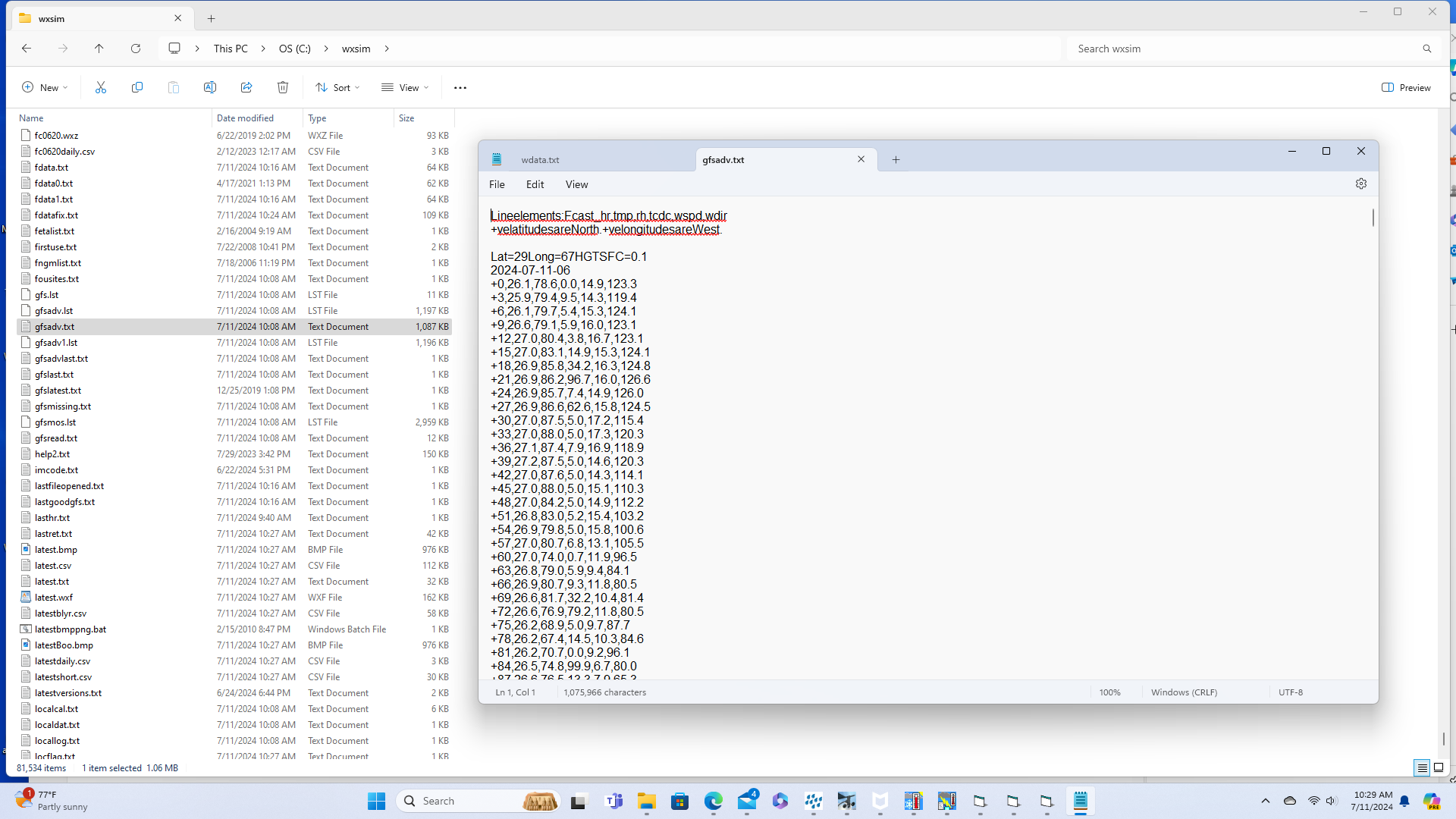

I really believe we need screenshots of both WXSimate and euromix, we need to actually see what is happening to try and work out why.
Until I press the Mix button I don’t see any run details…both values are blank. When you press Mix it should read the wdata.txt file that was last produced by WxSimate. It should then display the data from the file in the various fields/map and (I assume) that’s also where it gets the run details from. There are other places that it could get the run data from but as that information is in wdata.txt it would seem odd to the get the data from elsewhere.
So as gfsadv.txt and ecmwfadv.txt are both being updated I think you need to check what’s in wdata.txt. Best way is probably to open it in a text edit and then search for some text that’s at the top of the gfsadv.txt and ecmwfadv.txt files. You should then be able to see the GFS and ECMWF runs that are contained in the wdata.txt file. Depending on whether they match or not depends on where to look next.

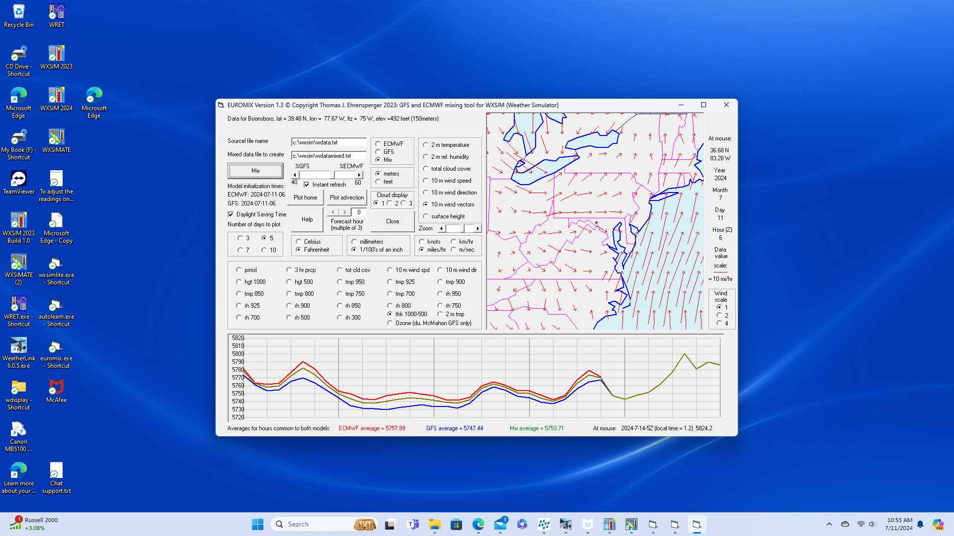

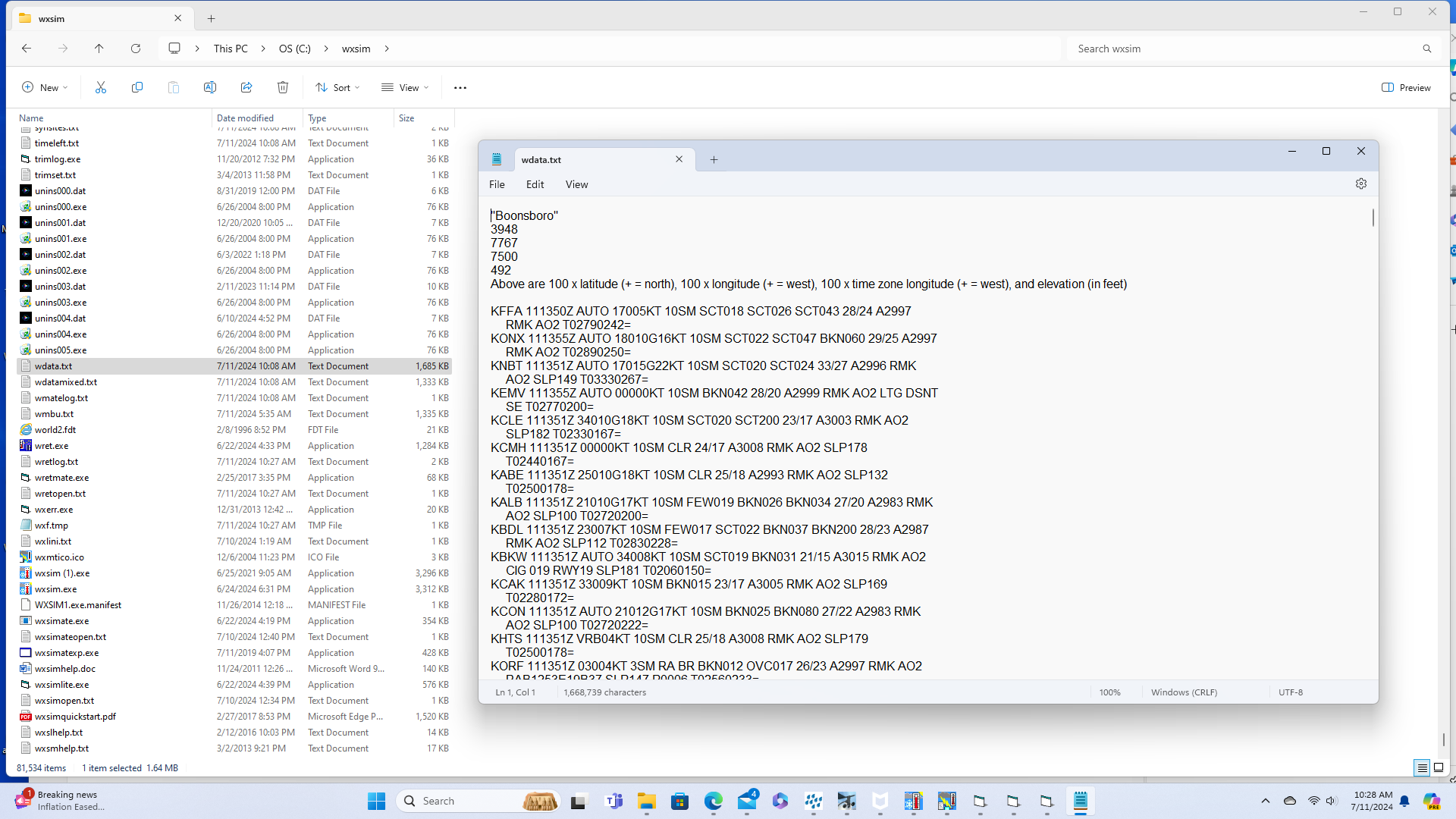

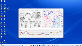

Chris,
Hope these come through okay.
This is right after my forecast run at 10:08 AM
Please let me know what else you need.
Dave

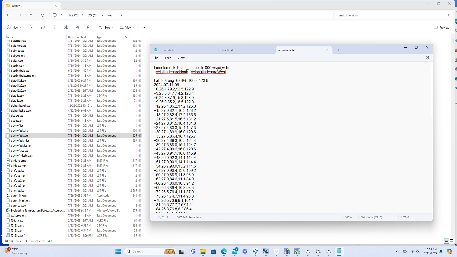

Chris,
Upon clicking the EUROMIX “MIX” button the Date/Time updated.
Hope these have come through okay.
The screenshots worked perfectly. It looks like things are back to normal. I’d expect to see the 2024-07-11-06 runs at the time you captured these images. We need to try to find a time when the run date/time seems older than it should be.
One thought came to mind…do you usually see the errors and old run date/times in the morning? Is there anything that happens to your computer/network overnight, e.g. does the PC or your router reboot? If it’s offline for some reason overnight then first thing in the morning you’d probably see old data and perhaps errors from failed overnight runs. Later in the day when everything has been up and running for a while, you wouldn’t see the errors and you’d have up to date data?
All those images are fine and mine look similar apart obviously from location :wink:

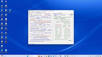

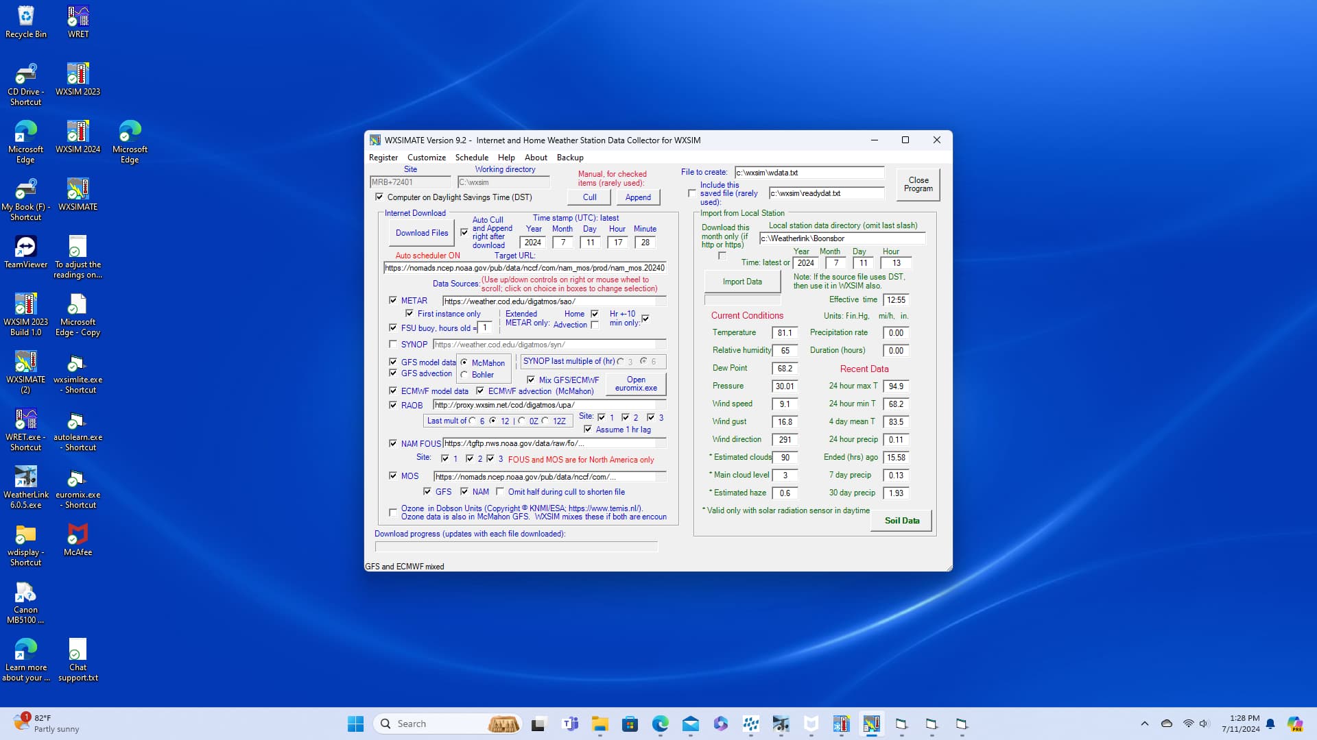

Can we see screenshot of WXSimate? Just to complete the view.

Stuart,
Here is a screenshot of mt WXSIMATE screen after my last forecast at 1:08 PM (WXSIMATE 1:16 PM run.
Was not sure of the UTC Time Stamp. Shouldn’t it be 5 Hours behind UTC? Maybe not.
****Correction **** WXSIMATE runs at 1:08 mins after the forecast hour not, 16 Mins. a
after the hour.
I don’t think these screenshots are showing anything useful because when they were made the data seems to have been correct with no download errors. We need to look at the data just after an error occurs to see what has/hasn’t updated.
