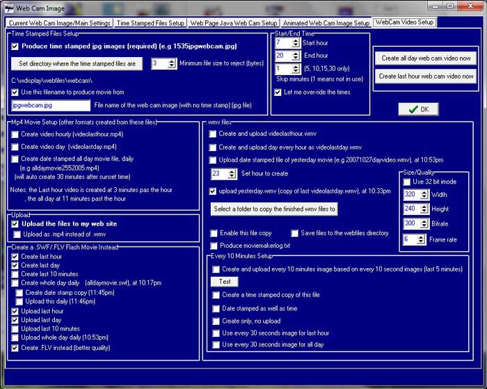

Brian,
I upgraded to the latest version but I am still not getting the video file “yesterday.flv”, I have to create it by running a batch job to copy videolastday.flv at the end of the day.
Attached is my webcam image setting. Thanks in advance Dave.

Hi There,
You can use the swfobject program that will install flash if the viewer does not have it (WDL uses it), or you can edit the following lines from VideoGallery.html file.
the javascript from line 5 - 280 goes in the of your new html file.
the javascript from line 289 - line 312 goes in your along with lines 313 to 319.
If you want to put the gallery in a of a table then just put lines 289 to 319 between the items of your table.
All the Best Dave
