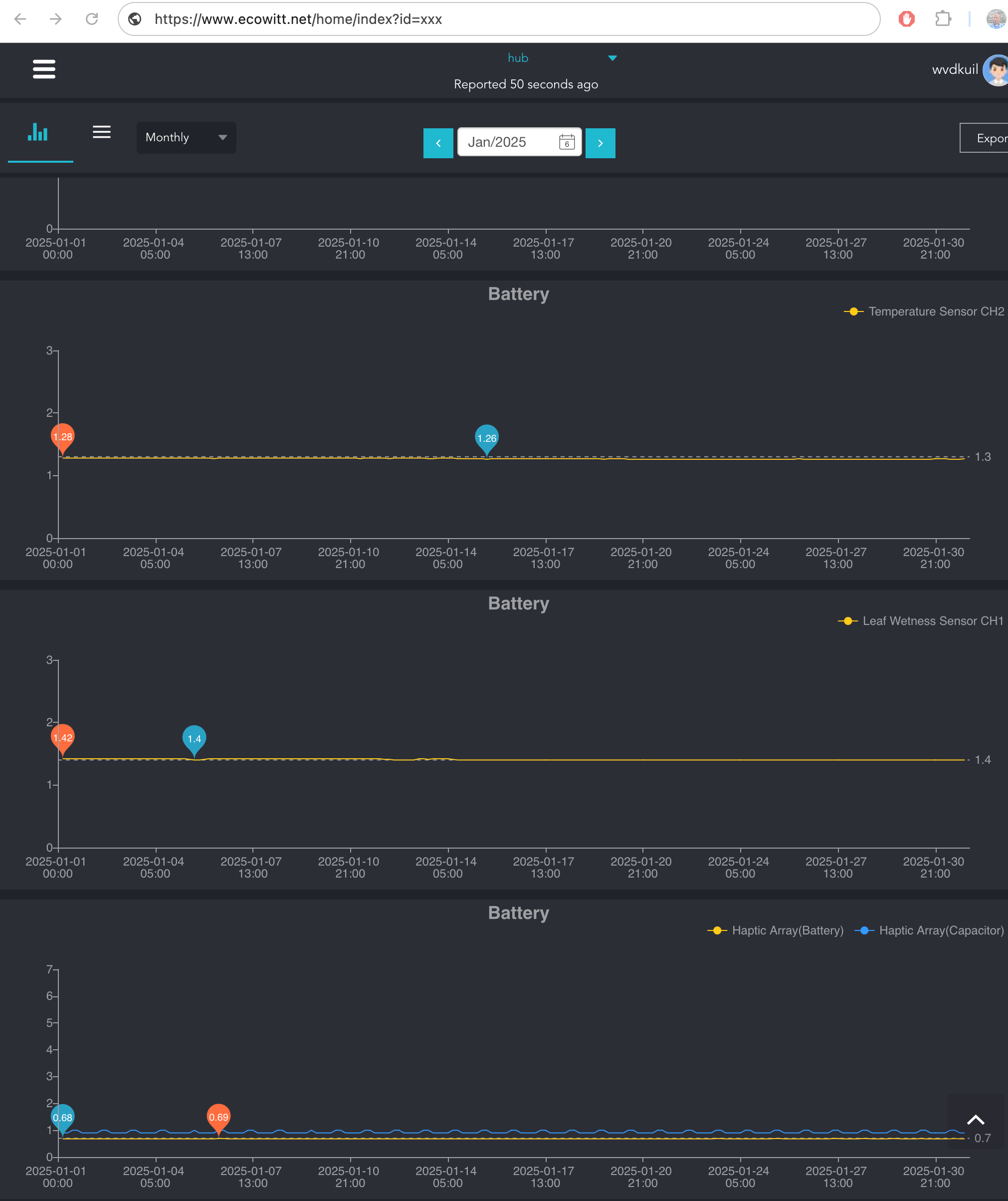

At the end of a long cloudy winter the outdoor unit often has depleted batteries. At least at my latitude (Belgium)
An Ecowitt Wittboy WS90 Outdoor Sensor can be used with either an extension cord connected with a DC 12V/1A Power Adapter or an extension Battery Pack
Some other outdoor units (f.i. WS69 ) can also use an extension Battery Pack.
If your outdoor unit comes back alive after the sun starts shining longer on the unit, you could consider adding an extension battery pack before the next winter.
At ecowitt.net you can check the battery levels during the last days/month.
