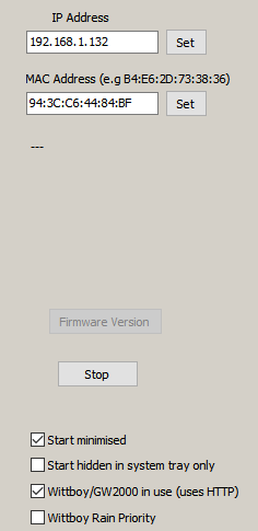

I have no WeatherFlow, so I just use the basic settings:
and I have GW2000 selected in crongw1000:
i don’t have a weatherflow system but it picks up the settings from ecowitt.
Yours looks different to mine?
Mine are just from Control Panel > Station Type & Settings > Ecowitt/Froggit tab, yours are from Setup > Advanced/Misc Settings > WMR968 Modified sensors/WeatherFlow/Ecowitt.
Okay i dont use that bit i use the one previous as that seems to work perfect and with this, and allows me to add tags that i need, it shows up everything i want and show everything in the wd dashboard (Which I am still customising)
Strange, my graphs for WD show correct solar and uv data for all time ranges. I only have the main Ecowitt settings in use. Well I say correct I mean what WD thinks are correct!! I can’t check further as I’m not at home right now. So the graphs on the steelseries should work.
