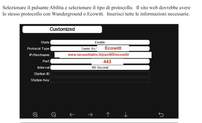

Maybe it is a typing error: make a screenshot/photo of what you configured in your console.
It should be:
Ecowitt protocol NOT Wunderground
www.lacasettabio.it/pwsWD/ecowitt/
Port 443
Interval 60 <= you can later on set that to 120.
