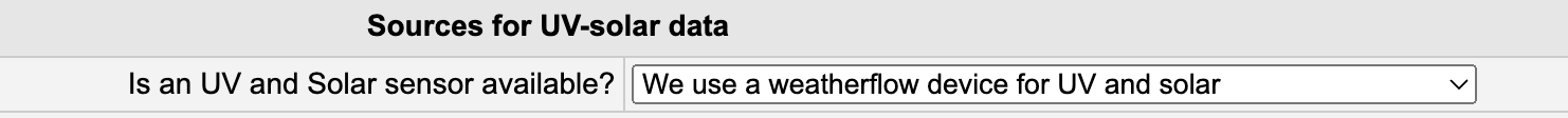

LATER EDIT: Well, well, well - faulty memory cells. Turns out the solar switch was NOT on. . . now it is on, PWS is showing UV at last. And solar display has dropped to zero, because I don’t have solar. (The solar that was showing was only their estimate.)
All I have to do now is get rid of the ET display on WD main screen. . . and the solar descriptions of cloud cover. (DONE!)
