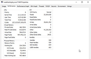

I tried programerrorlog file but no joy. Help > About WD still displays the memory usage, but it never gets very high. I already have it set to free up memory twice a day, just in case :wink:

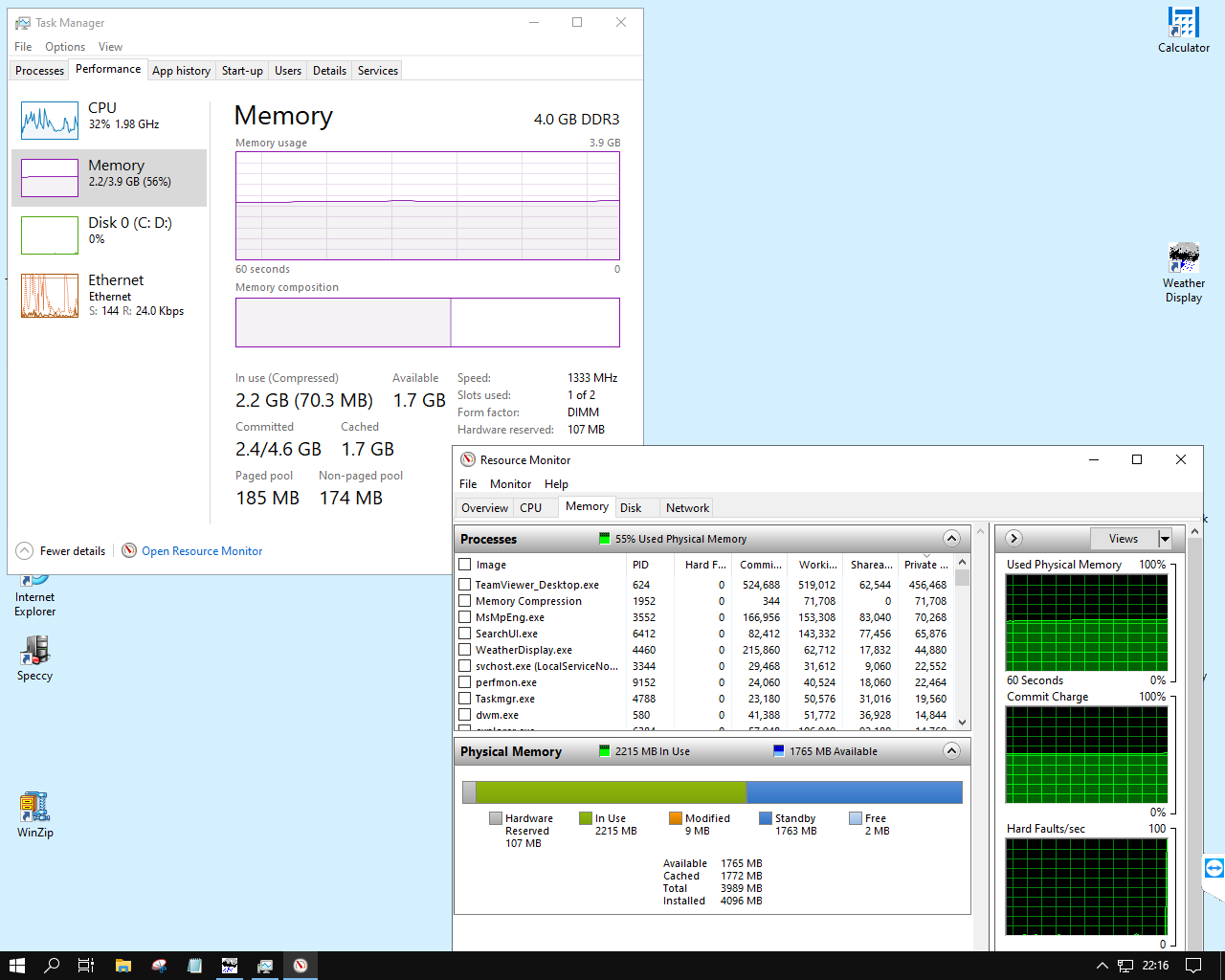

I monitor memory with the usual Windows tools - Task Manager and Resource Monitor - as shown, but I’ve never seen anything untoward. Mind you, I’m probably asleep when the darn thing goes critical. . . which is why I’ve taken to restarting WD before I go to bed. The actual computer has now been up 37 hours with no problem, which has not happened for a while.

As shown in Task Manager, top left of attachment, 4 GB. Only WD and TeamViewer (and a million Windows processes, it seems) run on the machine, which should not be in the least stressed.
I’d found 4GB was a bit anemic and went for 8GB … as windows gets updates, I find a creep in the number of windows things loaded in memory and consuming resources. It may be that 4GB just isn’t large enough to hold 'em all and run indefinitely.
