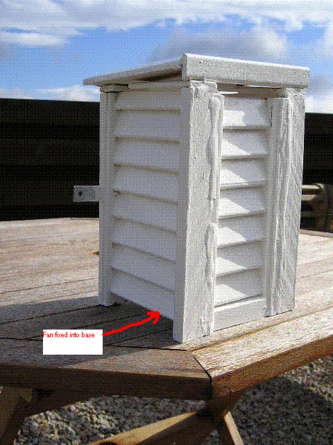

Even here in Scotland using a WMR928N, I find that I am developing a warm air pocket in my home made Stevenson screen. Just bought a solar panel and computer fan and in the process of sorting it out so that when the screen is in direct sunlight the fan aspirates the area around the sensor.
Kojack
I would be interested in knowing how you get on with this, particularly in how you stop water getting into the fan. I would like to do this with a VP ISS. I have a spare processor fan, do you think this would be OK?
So far so good Bob. My tweaking seemed to work. The fan is mounted inside my mini homemade Stevenson screen below the thermo/hyg sensor and should be well protected from all but driving rain.
