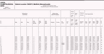

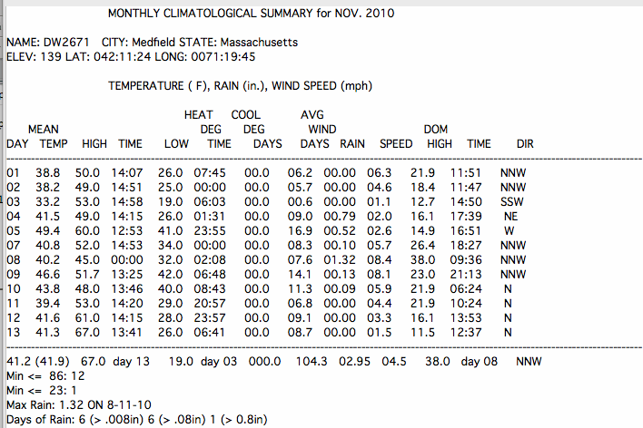

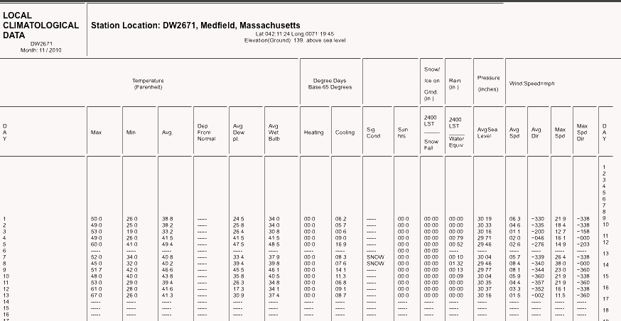

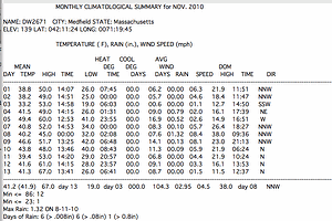

Hello, while trying to figure out why my $snowdaysmonth tag is not working (I need to manually update this tag) I discovered that the Detailed Climate Report and NOAA data are not properly capturing and reporting the HDD and CDD. In mid November there are plenty of HDD’s and no CDD’s yet WD is retrieving 0 HDD and somehow reporting CDD when there should be none. Any ideas?

To be honest I have no idea what HDD and CDD represent, but mine look similar to yours, all CDD and no HDD. I never researched them as I always thought they were most beneficial for farmers or anyone who is trying to grow something…

I hope your Holidays went well. This post strayed a bit from it’s original message, however the issue still exists. The snow tags are not holding in the climatedata.html, clearing out after midnight ( http://discourse.weather-watch.com/p/381424 ). Also the HDD/CDD values are bogus. I’m hopeful you may be able to find some time to look at this, there are other similar posts out there regarding issues with the climatedata and noaa reports and I wonder if somehow they could all be related.
