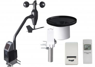

There is a jungle with different stations. Is the HP1000SE PRO a station that could work in your opinion or is something more needed? Grateful for any tips!
(Froggit Wetterstationen Shop - HP1000SE PRO Single Sensor Edition - HP1000SE PRO Display inkl. Innensensor + DP40 Aussen Temperatur/Luftfeuchte + DP80 Regensensor + DP300 Anemometer)
Best regards Jan :smiley:
That is a very fine weather-station with the best console available.
BUT to connect the station to WeatherDisplay you also need a Froggit DP1500 (same as Ecowitt GW1000 )
That very small device has an extra API that is supported by most weather-programs.
Although it is extremely small (box of matches size), it is an advanced console without the code to display the data nicely on a piece of glass as other consoles do. But is has that extra API so that multiple weather-programs can listen to the DP1500 and get all weather-measurements.
So if you do not want a glass-console you can choose the DP1500 with the same sensors as the HP1000SE PRO, that is this configuration
You then use a tablet and the ws-view app to do all configuration and display all sensor values. And maybe your own website also.
Succes, Wim

Now I am the happy owner of: Froggit HP1000SE PRO Single Sensor Edition with DP40, DP80, DP300, DP1500 and a DP60. :lol:
