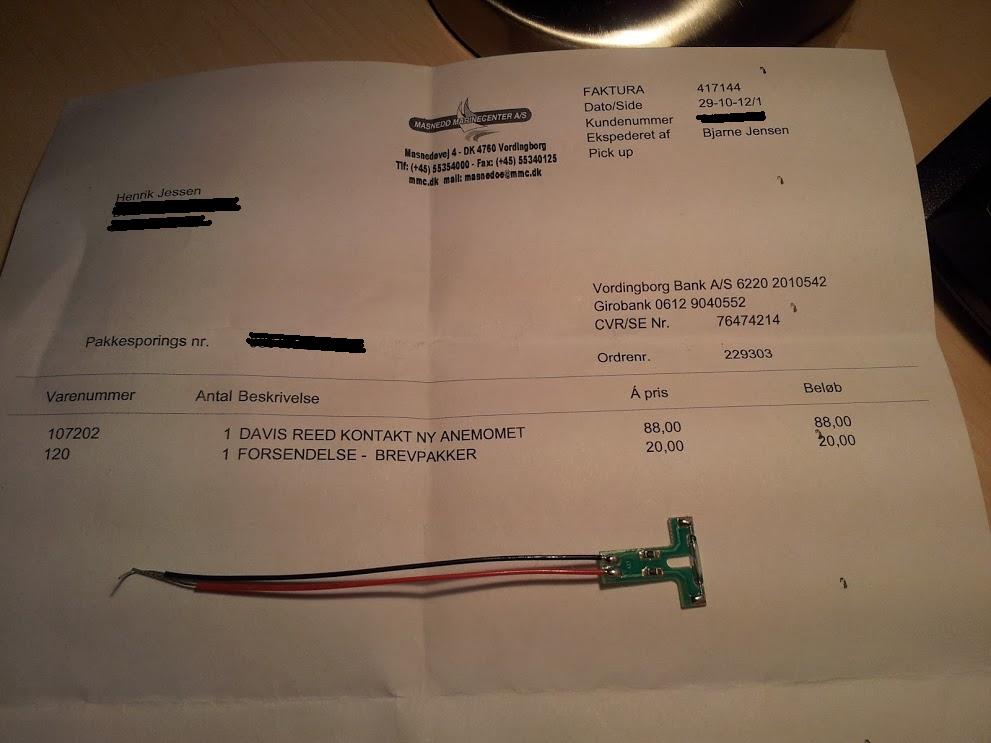

Im having problems with my Davis VP2 anemomenter. Windspeed is stopping 3-4 times amonth.
The solution is to loosen the windcups and press them to the top and tighten them again.
I have been in contact with the Danish reseller - and he thinks its a bad reed-switch - so I ordered a new one for replacement.
Yesterday I tried to disasemble my anemomenter - but had to give up - I was affraid to break some of the plastic housing.
Anyone who have tried to change reed-switch in the anemomenter? I have been searching a lot - but havent found anything usefull guides so far.
See attached picture of the reed-switch.

I have done this numerous times,
My spare anemometer is currently offsite as a replacement to a customer, but as soon as I get it back I intend to write a “how to” guide.
Watch this space.
