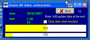

I’ve noticed since upgrading to 37f build14 that the Davis data retrieval dialog box progress bars appear to have changed, the bottom of the 2 bars which I’m assuming shows the progress of retrieval from the consul only gets up to about 10% (after switching off overnight)before upgrade this used to go to 100%. The top bar which I assume shows the data being processed works normally to 100%.
checking the log file shows all the data as correct just wondered what was happening.

After shutting down again last night, restarted this morning same problem bottom status bar only go to 10% (see Attachment) although all the data downloaded correctly and nothing appears to be missing, guess I’ll just live with it at the moment and keep checking. big test when I go away soon and have to download 2 weeks worth of data

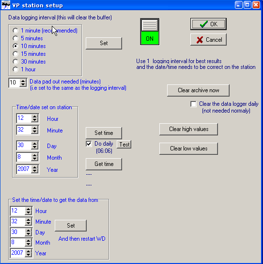

have you changed the logging interval stewart to a longer period than what you have actualy have set in wd in the data logger setup?
that would explain why its underestimating the amount of data

I did change the logging interval to 10mins, (to cover going away) just checked and this is set correctly both on the consul and in Data logger setup.
I just tried changing the logging interval back to 1min, lower status bar ran to the full 100% as normal, so it would appear that changing the logging time has an effect on what the status bar shows percentage dowinload wise
