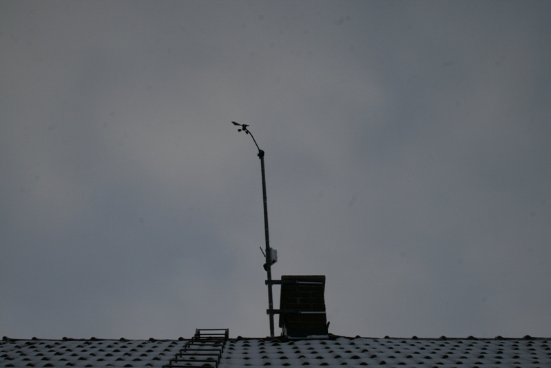

Here is a picture of my setup, and as you could see there is a ladder so I have no problem getting up an replacing the battery.
