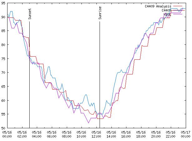

I have a daytime FARS I added this winter. So far this year we’ve had some temps in the 90’s and it has tracked well. The sensor unit is in a very exposed location, with intense full sun, and little evaporative cooling from the ground around since it is surrounded mostly by dry land (sage brush and cheat grass, no trees). Graph #2 shows when it was hot a couple weeks ago. The graph shows my station (CW4409) in blue and the nearby automated airport station about 8 miles away in purple (and a line for an average of surrounding home stations in red). There will be some microclimate differences because the airport is in a flat area, and my sensors are at the top of a small hill. The real test will be this summer when it gets hotter and the air is still.

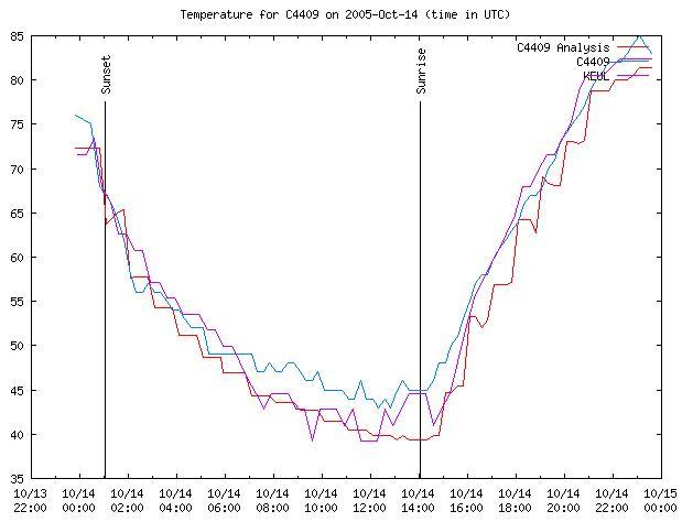

I only started sending to CWOP last fall, so I don’t have a good comparison graph from before I got the daytime FARS, but the first graph shows a day during last fall when it was in the 80’s.
