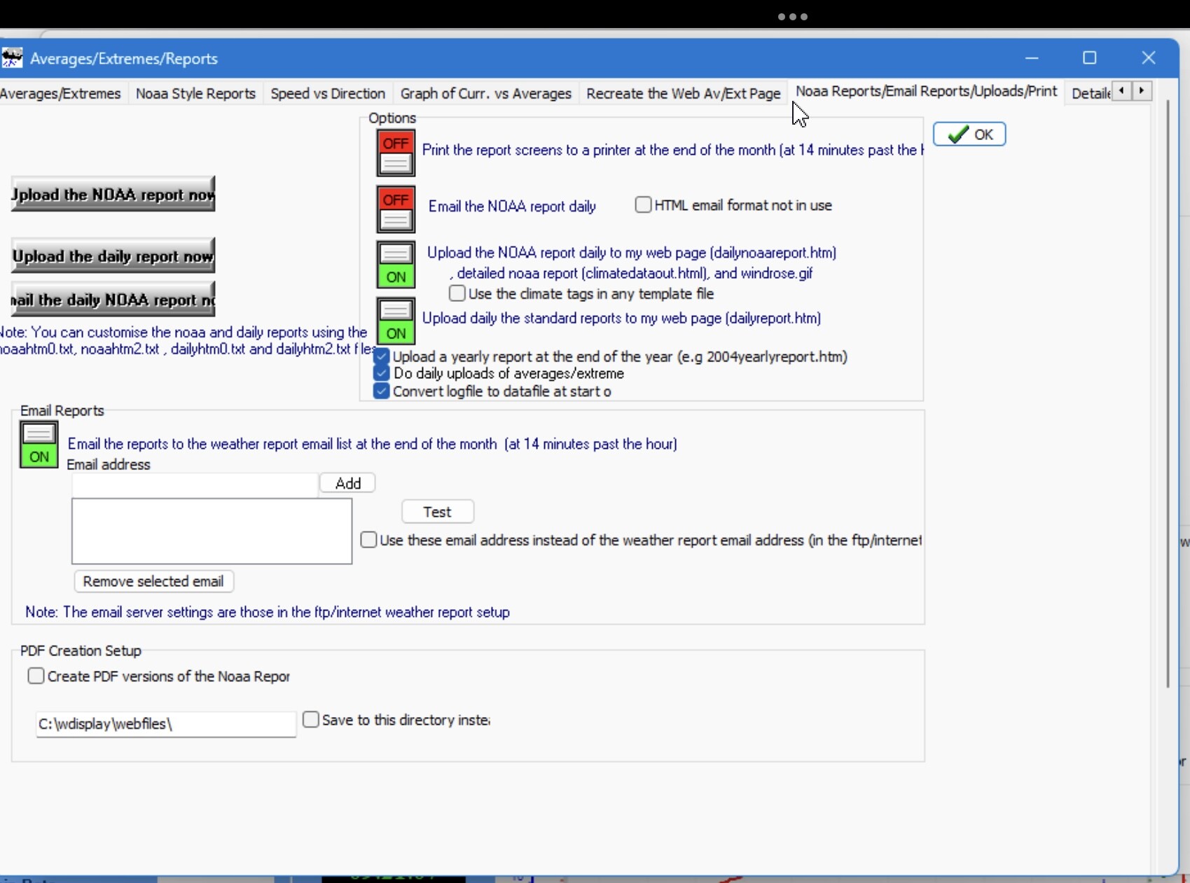

In late November I had a FTP upload issue with my Webpage host, which turned out to be an FTP vs. SFTP issue. But in figuring this out, I made the mistake of clicking the box in WeatherDisplay to “delete windows registry to reset FTP/Internet settings.”
I have since rebuilt all the file uploads with apparently one exception: The report that generates daily and creates a new file monthly named, e.g., November2023.htm. see e.g.: Daily Report
The December file isn’t creating and I can’t for the life of me find the setting to create and upload the file. Can someone point me in the right direction? Thanks
View Menu
Averages/Extremes/NOAA Style Reports
Recreate the Web… Tab
Select Month and Year
Create
Once created the file is in your webfiles folder.
You have to manually upload that if I can remember correctly.
I think you need to see this page in setup
Thanks to both of you. file created and uploaded manually. Will watch to see that it updates tomorrow.
