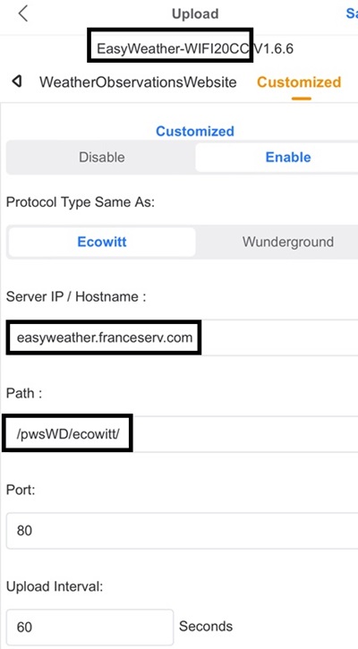

I prefer to use a custom uoplad ecowitt with my HP2551 console
how to do a new “clean” uoplad template installation ?
I already have a custom uoplad which currently works but for my GW2000 gateway
I suppose I would have a problem with the file=ecowitt/ecco_lcl.arr :pensive:

'I’ve used the model for several years yes (but not only) I left it aside because I was developing another weather project
A few weeks ago, I took it back and re-installed it for my setup. So in the meantime I found myself here looking left and right to see if there are any further updates
I can stay with PWS and I hope it doesn’t bother you, although from time to time there may be questions that are obvious to you but not to me who sometimes gets stuck in the system…
Happy to find this post … I recently changed to a new device and uploads were not working. I did notice a ecco_test.arr drop into the folder. So I changed easyweather data path to match (test.arr instead of lcl.arr) and it worked.
After reading this topic though I deleted ecco_key.arr and ecco_stats.txt and changed the easyweather data path back to lcl.arr … and all is good in the world again. :smile:
