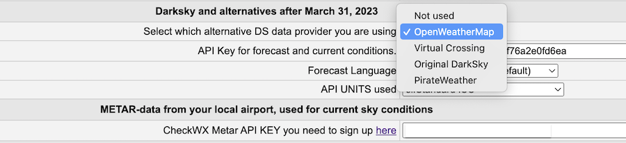

At March 31 DarkSky will not longer be available. The latest updates contains replacement scripts and updates in other scripts.
Separete topic about those scripts http://discourse.weather-watch.com/t/3044.msg585736.html
If you are not using DarkSky or one of the replacements:
Run easyweather-setup and remove the contents of the DarkSky API field
Other scripts test this API-field and use it for 1-hour forecast (metar script) or UV-sensor (UV-solar block).

Not so much offline, but not working at all for me.
I’ve downloaded all of the updates, changed to visual crossing and put in my API key.
Forget that, it updated by itself.
Mapantz:
@ ALL
If you change from API, f.i. DS to VC you have to wait until the cache is old enough to be replaced.
Forecasts can take 1 hour, current conditions 30 or 20 minutes.
