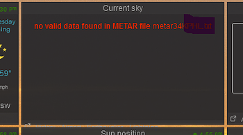

Current Sky was working until today and now it show “invalid data”. Updated scripts and still appears. Any guidance is appreciated. thanks
Does the METAR station you’re using still have valid data? Sometime stations shut down completely, or temporarily for maintenance so that might be the reason.

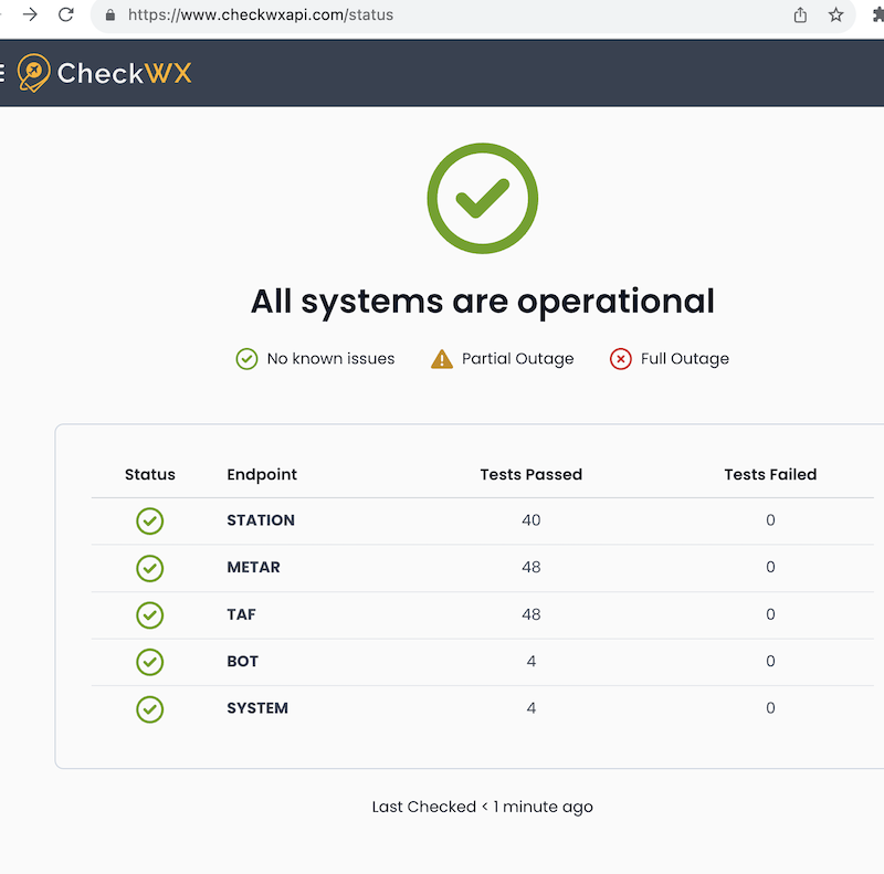

API Status | CheckWX Aviation Weather API (checkwxapi.com) shows a issue
As far as I know the METAR station is still operational KPHL (Philadelphia International). Is there a way to check, outside of PWS Dashboard to check METAR activity? I’ve seen “offline” errors before, which usually resolve within a day or so. As always, thanks for your help.

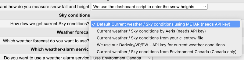

Solution: If you are using clientraw/Aeris/DarkSky-replacement or EnvironmentCanada, you can use them for the sky-conditions also.
