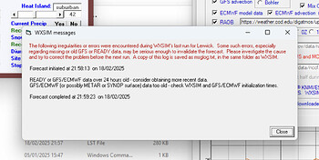

This is what I get when I run the forecast. WXSimate downloads without errors, the WXSim throws an error saying the GFS/ECMWF data are more than 24 hours old.
OK, I restarted everything again and the error has gone!
