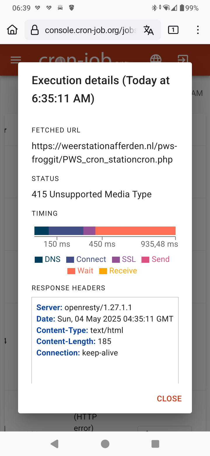

Cronjob has failed
Recently I have cronjob errors.
I myself did not do anything so that can’t be the cause.
Is there perhaps a solution that the cronjob will no longer give errors?
I can reset the cornjob but this only works for a short while.
I use [https://console.cron-job.org myself](https://console.cron-job.org myself)
URL: https://weerstationafferden.nl/pws-froggit/PWS_cron_stationcron.php
Last execution attempt: 05/03/2025 16:10:15 GMT (scheduled: 05/03/2025 16:10:00 GMT) Last status: Failed (415 Unsupported Media Type)
Kind regards
Piet Manders
what error is the cron jog showing in the details on on your cron-job.org
