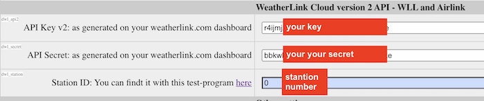

You need two keys and the station-id as described Find your weathercloud station
You enter the two keys there => click on “Go to find my station number”

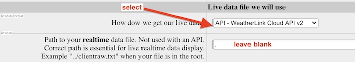

Then you enter the two keys plus the station number in easyweather and select “API - Weatherlink Cloud v2”
See attached screenshots

Probably you forgot to enter the station ID.
It is a step by step guide, you end with three values.
If you enter them as described in the settings, it works. Has worked dozens of times
Your 1 "API Key v2" and your 2 " API Secret" to the settings nearly at the bottom as in the picture above
For your 3 “station_id” you have to decide between
the setting below your “API Key v2” and “API Secret”
if you use the v2API for your station and extra sensors.
That station-identifier has 4 or 5 digits. It is never shorter!
The first station (first array element) => station-ID is the field labeled [station_id]
In the example below 88767

At the third page of Find your weathercloud station you can inspect the data returned for your WLL and check if you inserted the station-number.
If you do not fill in all three values in easyweather there can no data be loaded from weatherlink .com.
Great it works. strangely enough I found a WLL device ID in the software. That was a 12 digit (numbers and letters) ID … But it looks like it works fine with your info.
