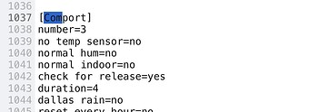

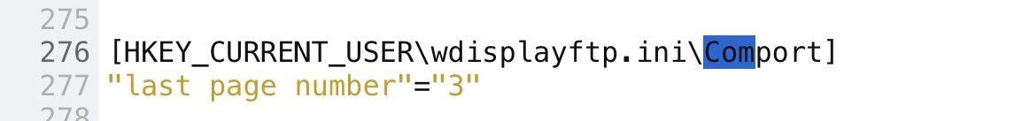

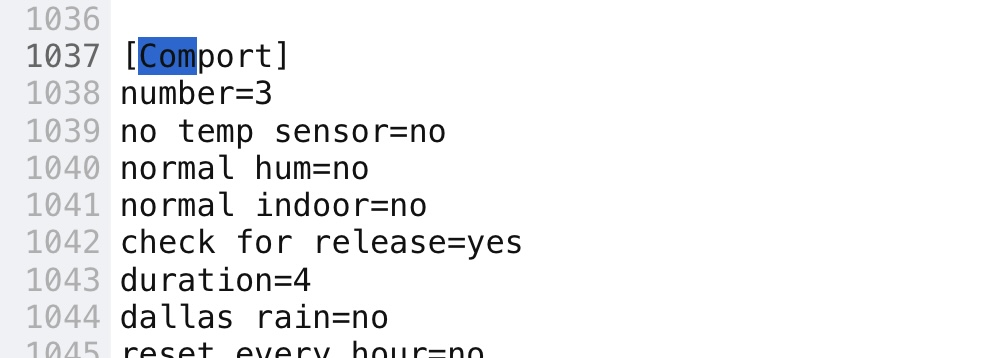

The com port is in both the ini and the reg files
Wdisplay.ini file
Wdisplayftp.reg file
So you will need to check they are both the same
Best to use action backup settings files then shut down WD then edit them if needed then copy the ini file to main folder and double click the reg file to get it to install

It contains: [HKEY_CURRENT_USER\wdisplayftp.ini\Comport]
“last page number”=“0”
There is nothing for this in the registry for this.

Any changes I make WD are saved in WDISPLAY.INI. I can close WD and reopen it and the changes are retained. When I reboot the pc all the changes I made are lost. They are back to the original values, before I made the changes. It’s almost like WD retained the values somewhere and reinserts them in to the settings.
Before I did anything on the new pc, I copied all the WD files from the old pc’s hard drive to the new PC. I installed WD and opened it for the first. I made the changes to the settings to have WD open with Windows and start minimized. Now, whenever I make changes to that setting, to not have WD minimized, after I reboot the pc, it’s back to minimized. All my changes do that. It’s like WD has the original values stored somewhere and replaces all the changes upon a reboot. I don’t know where WD is getting them from or why it would do that.
I edited WDISPLAY.INI and put an x at the bottom of file and saved it. After I rebooted, the x was gone. I also tried adding a text file in the WD main folder. After I rebooted the text file was still there. It seems like the problem is coming from WD and not Windows.

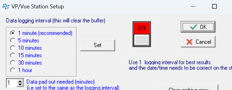

In WD goto control panel/stations settings/data logger and turn off extract data at startup. There may be no data? If you turn your computer off/on you may have to turn it on but there has to be some data.
windows sets the com port number for silab can be different number on different computers. You set the number in WD to what ever number silabs is set to, forget the old number.
I run my computer 24/7/365
I can’t seem to find that setting.
You are right about there being no data. I opened WeatherLink and tried to download data. I got a message indicating that there is no data.
I never had this issue with WD on any of the computers. I haven’t had any issues running WD on past computers.
It’s just Control Panel > Data Logger
You mean this?
WD didn’t check the logger after a reboot this time. Is this used for when the computer has been turned off for a while, WD will pull the missing data stored on the logger?
