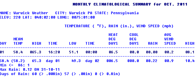

I noticed that on October 1st, the rain we had during the day was not displaying in WD (the 0.12in actually had the date of October 31st for the 1st)…(see below)

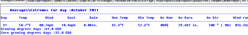

Issue #2…the Averages/Extremes for October 2011 was displaying the date October 31st…as the only data for the month.(also see below)
The first thing I thought about was the old problems of the month change over and the first few days of records being incorrect, however I know during the past several months that changeover to the new month was no longer an issue…
Using WD 10.37 bld 80
I’m seeing the same thing here, Oct is showing 31st. I think it’s still an issue with end-of-month when less than 31 days in a month.
Hi, I had the same problem with average\extremes for October it to was showing 31/9/2011, today this seems to sorted its self out now, but I had to reset all my selected all time records because I’m having BIG problems with my records I think that by resetting all records it fixed the date, but it has not sorted the problems with my all time records see site www.wilneyweather.co.uk .
