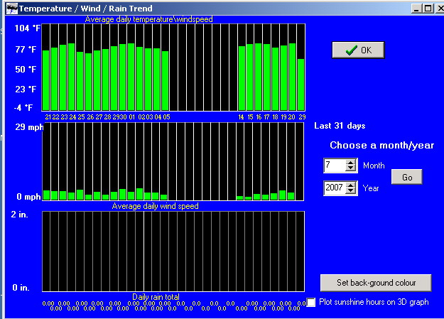

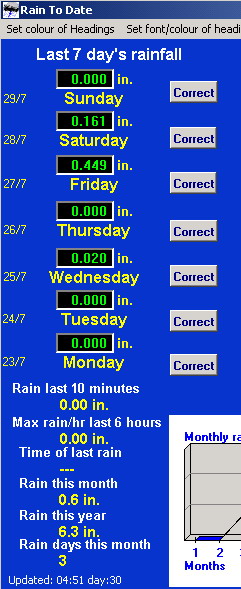

Just noticed that inside WD itself, one place does not reflect the recent rain (View, Temp/Wind/Rain Chart) while the other (View Rain Chart) does - see attached. Related?
The gap from the 5th to the 14th is expected as my computer had a bit of a problem while I was gone on vacation. :slight_smile:
Tony
that gap you see is the source of the problem for the data for the graphs for WDL
the other data is derived from the wdisplay.ini file (for rain for last 7 days)
that gap you see is the source of the problem for the data for the graphs for WDL the other data is derived from the wdisplay.ini file (for rain for last 7 days)
Hmmm. WDL is accumulating the total but you are right, the past 30 days is not working. http://www.thorntonweather.com/wx10.php
