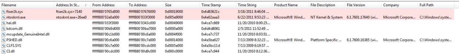

Since I have had to move all my WD software, files, and to a new computer due to a unbootable PC, I have had 6 Blue Screens of Death from 6 Sept to this morning, and number lockups of WD due to unknown reasons. Using a dump editor, the best I can discover is that these are caused by the Keyspan USB Adapter US-19HS. Maybe I should have installed the Keyspan drivers for the serial-USB converter, but for about 2 weeks after I got the new computer, all seemed fairly ok (no BSOD). The driver installed automatically by Windows 7 was an FTDI one with a date of 3-18-11, version 2.8.14.0 for USB Serial Port COM3 (which is what I have WD set for).

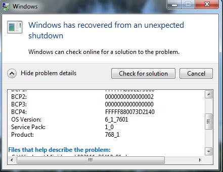

Attached here and in the next post are some 2 screen copies of details of the recent dmp file (Dump Info 1 and Dump Info 2), and the 3 screen copies of Windows Problem Details (Details 1, Details 2, and Details 3) on that BSOD. This is due to the limit of 128K per post.
