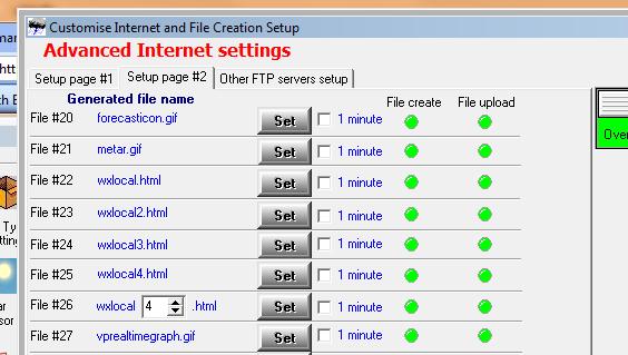

Can someone please show me there setup for the image below, i am assuming this is what your on about?

WD will rename if you have set it to do so in your Internet File Creation and Upload - File upload settings for that file.
You have wxlocal6.html for instance in your webfiles directory
WD will create wx6.html from that file.
In Internet file creation locate the wxlocal spin setting, select wx6.
Open that and set create times
then click on the upload settings and set upload times as well as the name you want the file to be uploaded as, including extension.
Seems to me that in the FAQs there are some screen shots of just that.

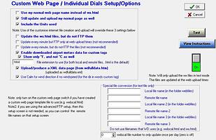

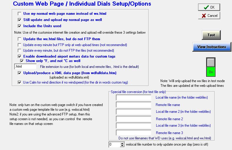

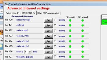

Also, i do not have anywhere in the custom file bit to change the name, see below, mine
aint like the image in the FAQ’s
Bashy,
In the settings for a wxlocal file you first set create times then you push the button that says “Show file upload times”
In that box there is a text area that says “Remote file name” at the very top that is where you would change say wx6.html to wx6.php or highslows.php, whatever you want the file named when it is placed on your web server…
