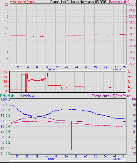

What would cause me to be unable to correct the graph data? My weather system had one of its
occasional temperature glitches (a sudden drop from +48F to -22F then back to +48F). In the past,
I’ve been able to use the correct graph data utility in WD, but this time it refuses to remove the
glitch. I also tried correcting the data in the log file then have WD convert the log file to graphs,
but that doesn’t work either. I’m running the current version of WD. Has there been a change to
the graph correction utility or log conversion utility lately? Attached the graph I’m trying to correct.
I’d like to see an option added to WD that would allow me to tell it to ignore these types of glitches.
It seesm like there could be a built-in way to have WD not respond to sudden changes in temps, etc.,
unless they persist for some preset time duration. That way, excursions like this could be eliminated
on a case by case basis.

make sure you are using the very latest version, as the correct graph data now does work
or edit the log file, 112006lg.txt, and then convert the logfile to graphs
also, if using a 2310 station, in wired mode, you need to replace the cheap data cables with better quality twisted pair shielded (CAT 5 sheilded)
its a must for all owners of that station

Thanks! I had just downloaded and installed 10.36t but had not tried correcting the graph again
since doing that; I had last tried with 10.36s. The graph is now corrected.
