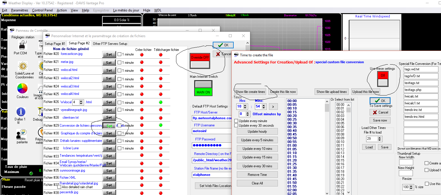

you need the switches on as in the attached screen shot
Ok i have just done all this, will see
Thanks Brian :slight_smile:
