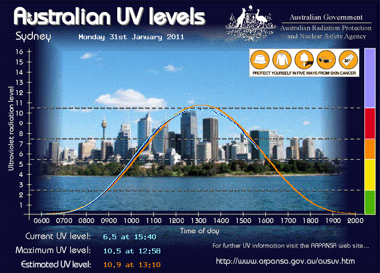

I’m trying to calibrate my new UVN800 by comparing my UV data with a government website set in Sydney, 80 kilometres north east of here. I am doing this by going into Control Panel > Offsets and Initial Rain > VP UV/ET > Davis VP UV Offset (% Adjust). While I don’t have a Davis UV meter, adjusting things here seems to work anyway. You can see the situation for today (very sunny and bl**dy hot) in the first attachment and the government data in the second. I adjusted it all from +15% to +12% around midday today.

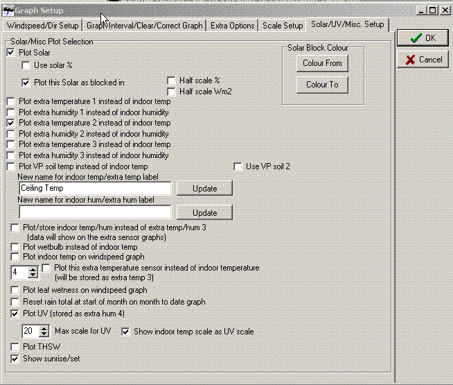

You have to look carefully at Attachment 1 to see the effect. Before midday, solar and UV were about the same on the graph; after midday, UV is below the solar level. My settings are in Attachment 3 if that helps.
