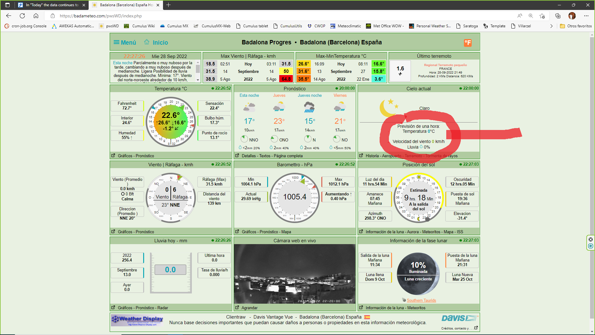

Good evening, could someone in the forum explain to me what the data that appears in the “Current Sky” block indicates never changes and does not refer to the area.
I attach a screenshot
the test module Module test PWS_Dashboard is showing errors for Darksky the current conditions because there is no data in the 2 data text in the jsondata folder and the file show an error 401
this suggest the api key for darksky is wrong or missing in the setup
And aeris_ccn.json is invalid?
Solved
