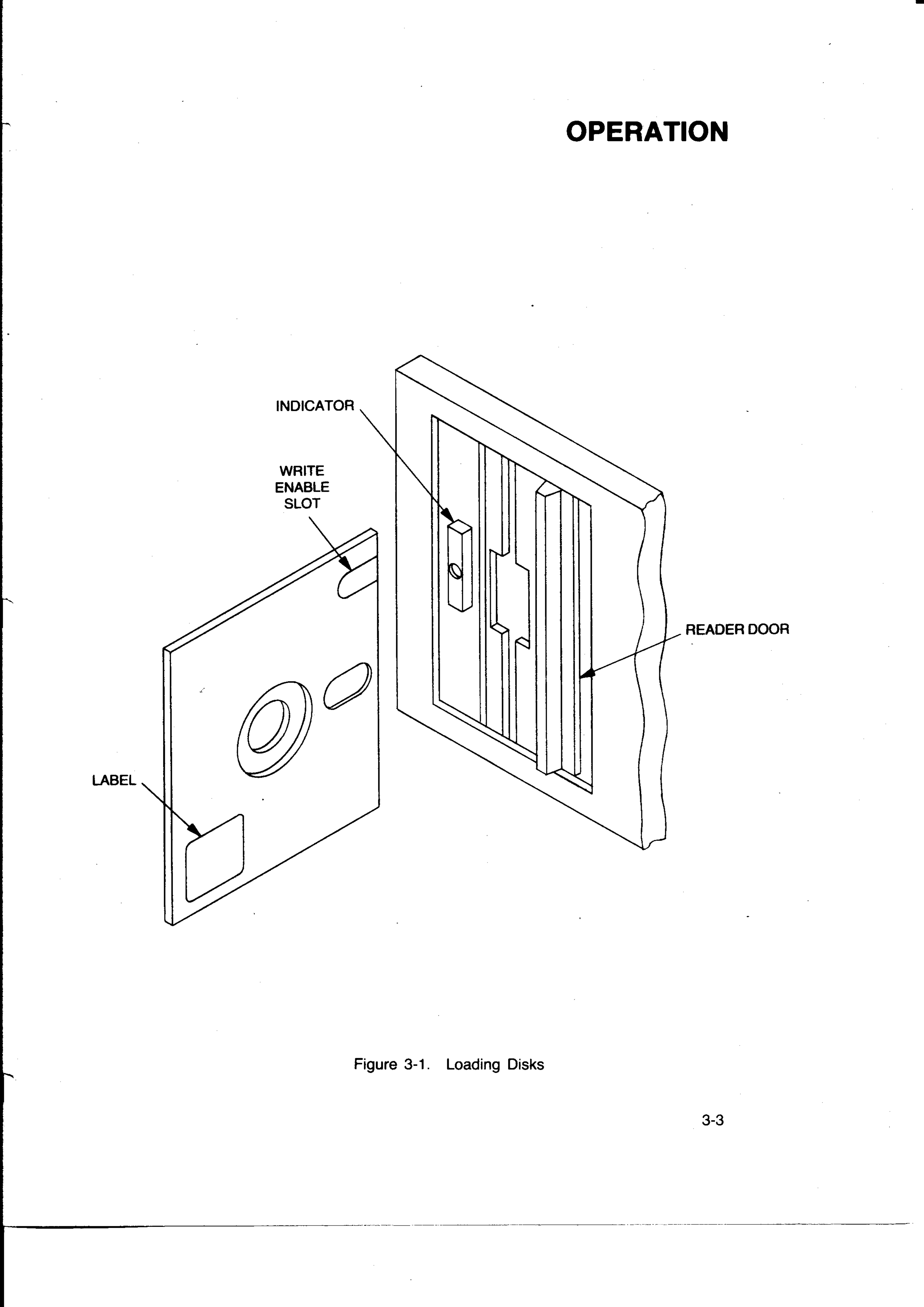

Illustration from Linoterm phototypesetter manual, late '70s, showing 8" floppy:
I think the first computer I used 8" floppies on was a Cromemco System 3. That would have been in 1978 or 1979. I was also using paper tape for program loading/saving and punched cards for code/data input too.
