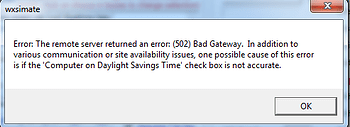

When downloading the data via proxy.wxsim.net, I get a bad gateway error. I tried connecting directly via the web browser, and this says the same.
I assume there is someting wrong with the server?

Seems to be proxy-wxsim.net/cod/ folder that’s at fault as both METAR & SYNOP are throwing the bad gateway error at the moment.
If it is trying to obtain the information from the College of DuPage site, that entire domain is currently down…
Yep, just spotted the same thing when Digital Atmosphere ran. The weather.cod.edu links from the Collage of DuPage are down.
I swapped DA to download from Northern Illinois Uni and those links are good, unfortunately we can’t do the same for WXSim.

This is also in the WxSim list: http://proxy.wxsim.net/tgftp/data/observations/metar/cycles/16Z.TXT
I switched to that, and it worked fine. At the College of DuPage, I looked at whois.com, and their domain name expired on July 31st. This is why they are down.

It works for the METAR, John, but not SYNOP as there’s only the one URL (that I can find), so the error shows when it gets to the SYNOP download.
ROAB has a second URL option but nothing wrong with a third option for upper air data.
Now, here’s a strange thing; I’ve just done a search on Collage of DuPage and the links from Google sent me to a HTTPS site that’s working, as is the digatmos folder: Index of /digatmos
Maybe it they’ve just switched from HTTP to HTTPS this weekend and that’s all that needs updating?

Really weird. I just tried both http://weather.cod.edu and https://weather.cod.edu/ and they both returned connection reset, could not connect.

Just tried the WXSIMATE downloads twice and all data downloaded without issue both times, including METAR, buoy, SYNOP and RAOB.

Website is back up.

FYI: The College of DuPage website is still down. Those using the site for SYNOP are going to be out of luck until this gets resolved or Tom chimes in and is able to find another source for that.

There’s been more issues with the website today, according to their Twitter feed.
A post 18 minutes before I posted this says it’s been restored and data is available again.
I just tested WXSIMATE using most or all of the links, with no problems. Maybe it was a temporary problem with the COD site? Are any of you still seeing problems?
