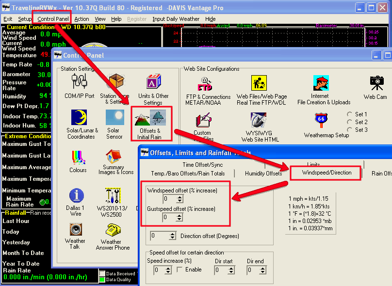

Make sure you do not have an offset in use…see attached
no…it’s 0 (zero)…
In my weather display live the max gust ok…
