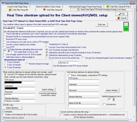

It is on, it has always been on and it does not start automatically.
I will upload a screenshot later, in a hurry now.
version: 10.37Q build 28; Windows 7; Evrything else works fine.
