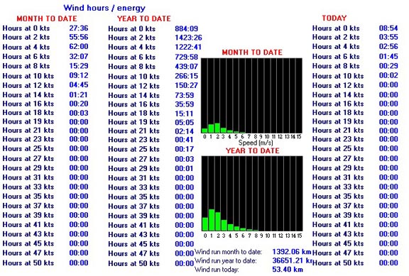

How about the Wind / Energy table produced by WD. eg Mine for this year so far…
Edit: just a gentle zephyr here in Elgin, even with the anemometer mounted well above the roof line…ie No good at all for a B & Q wind turbine :frowning: :frowning:
I think WD only creates one for the current year to date, otherwise that would be a good chart to use.
change the year or month and click on load values (bottom left corner)
:oops: :oops: :oops: I’ve just spent 10 mins trying to find out how/where to do last years wind/energy and have come to naught…agggghhh…mutter mutter…HELP!!!..PRECISELY how can I do it? starting with “WD… (control panel maybe, or View…etc etc”)… :oops: :oops: :oops:…( no doubt #-o #-o will follow)…
:oops: :oops: #-o #-oEDIT: The instant I posted it I found it…WD/View/Logs (Wind energy)Right Hand side of panel/then as Brian says above…mmmm (but my data doesn’t cover the whole of 06 anyway)…#-o #-o #-o #-o :oops: :oops: :oops:
That shows some strange info. The hours for the year only add up to just over 4000 instead of 8760. Now I know I’ll have had a few outages, but nothing like 6 months worth!
Also the hours for each speed range are… 372/434/786/350/99/898/576/… I’m puzzled why the 9mph value is so low compared to those either side of it.
Finally, the month to date speed ranges go 0/2/4/7/8/11 and the other two ranges go 0/2/4/7/9/11. I assume the ‘8’ in the month to date column should be a ‘9’?
There’s definitely something wrong with the annual numbers. The hours at 8mph for November was 118:18 but the total at 9mph for the year is only 99:19.
when using those load buttons, WD calculates the hours from the data files (i.e adding up each minute of logged data and so adding hours at each speed)
compared to the first values you see when you go to that screen, which is from stored accumulating values
i will check on my routines though
