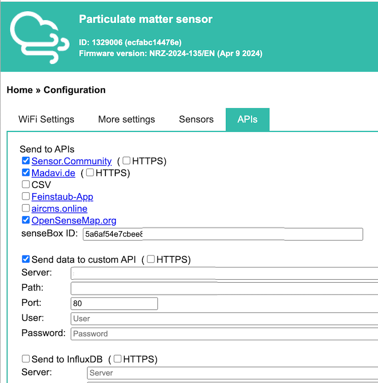

How to se “Custom upload” of your “Luftdaten-sensor” data
  1. Check your sensor number in eaysweather settings.
  2. Login to your local Luftdaten-sensor and go to “Configuration”
  3. Select “Send data to custom API”
  4. Enter server name of website, in your case weatheryyc.ca
  5. Set path to /pwsWD/others/sensorluft.php?sensordata
If you have an older sensor the https support maybe “problematic”.
If so do not use https and use port 80
You have to adjust your .htaccess to allow http traffic
Otherwise use HTTPS and set port to 443.

The “sensorluft.php” script will receive the data and build a “file” with current and 24 hour values.
After a few uploads the AQ_luftdaten2_c_block block will show valid data.
Seems to work OK now :grinning_face:
thanks for your help with this.
