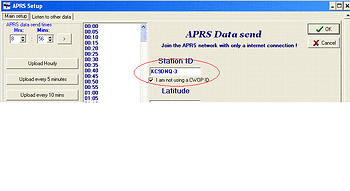

You should be able to add the dash, see my screen capture.

Maybe the trick is that “not using a CWOP ID” check box?
Thanks to hydrowx and his screen shot and niko for noticing the check mark. I have checked the box for not using a CWOP ID and it works now with a -4 !!! Amazing how the most obvious answer is usually staring you in the face but you are too blind to see it. :oops:
