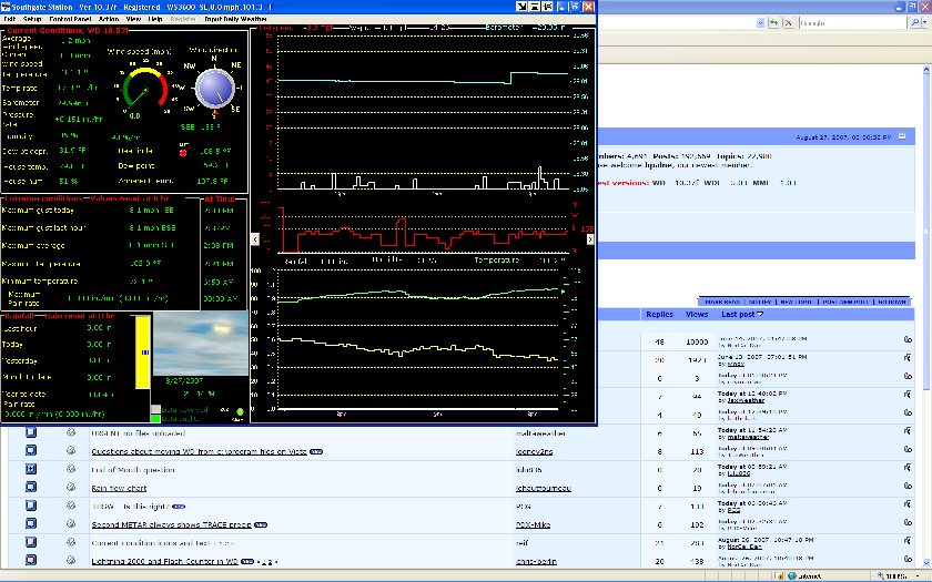

Attached is a “whole-screen” shot of my desktop. I moved some stuff around to make it more legible(sp?) and saved it. Now when I minimize it to the tray and later bring it up again the main screen shows where it is shown in the picture but the entire rest of the screen is black. I can go back to the main screen customize and click on Use Last Saved and it returns to normal. I’ve been trying to solve this myself but am not having a lot of luck. Anyone?

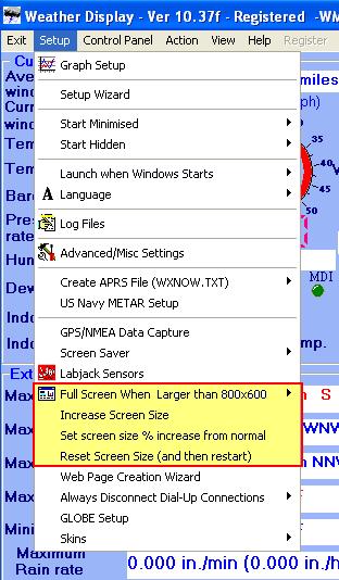

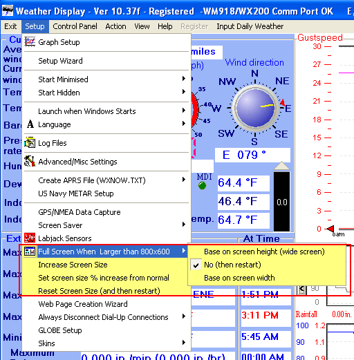

Are you using the screen size setups in the main setup menu ? (see below) The reg key I mentioned controls the “Full screen when larger than 800X600” settings. Those are different to the Main Screen Customisation setup, and might be conflicting. Try just clicking the “no” setting on the “Full screen when larger than 800X600” menu as a test. Also, after you clicked the “Use Last Saved” in the Main Screen Customisation setup and it went from black to normal screen, did you try clicking the “save” button immediately after clicking the “Use Last Saved”?
That wasn’t checked but “show scroll bars” was. :oops: A fresh pair of eyes almost always solves a nagging problem. Thank you :smiley:

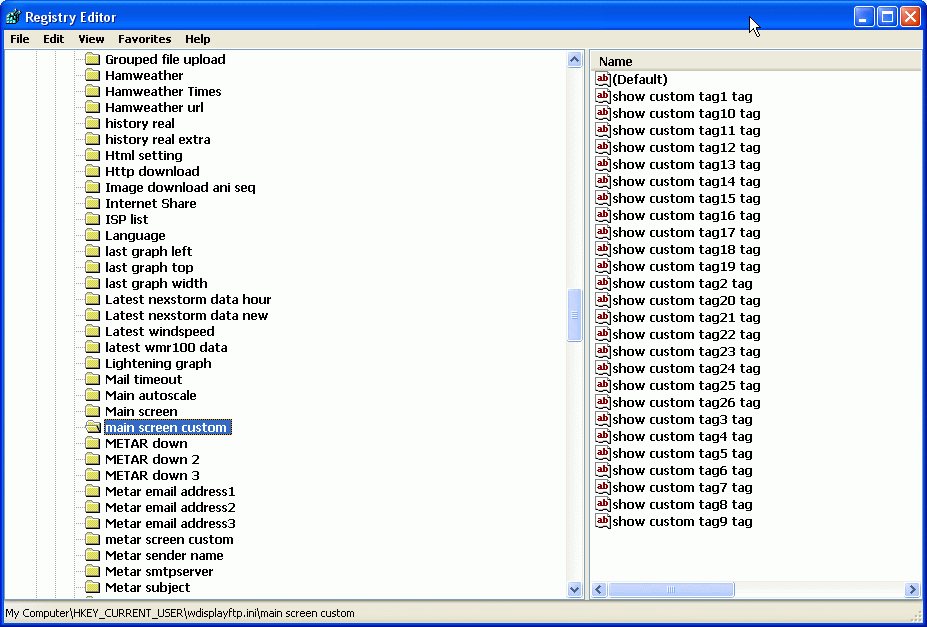

in the registry, in the wdisplayftp.ini settings, find
[main screen custom]
mainscreen x=
mainscreen y=
and delete those settings and then restart wd
I don’t think those settings exist?

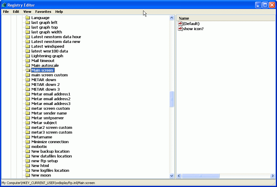

Maybe in Main Screen (not custom) ?
Not there either.

solution: (I have your setings)
setup
then click on
reset screen size (and then restart)
and then restart WD
then its fixed
(you must have set a use % size at some stage (setup, set screen size % from normal)
