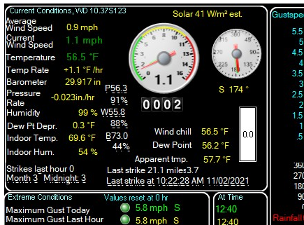

Finally, the little shadows i had on the screen shot of the console on my web page have reappeared. See http://personalpages.tds.net/~jsaltman/ and scroll down to the screen shot. The custom tags have a ‘shadow’ underneath that actually looks like a little bit of the top of the character. Its on the extra temps and lightning stuff.

The little shadows i had on the screen shot of the console on my web page have reappeared. See http://personalpages.tds.net/~jsaltman/ and scroll down to the screen shot. The custom tags have a ‘shadow’ underneath that actually looks like a little bit of the top of the character. Its on the extra temps and lightning stuff.

and for the labels on the screen shot
try
https://www.weather-display.com/downloadfiles/weatherdisplaytest.zip
and let me know

The sunrise/set stuff isn’t really a problem, i was just making note of it. the underlines on the screen cap are the webpage are attached. This is the autoupload of WD data to my website.

the ghosting should be OK with the test version, yes?

The web page has lost its lil underlines on it (being fed by the Ecowitt test file) thank you.
