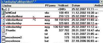

Hallo guys.
I trouble with generation wmv files. Mpg files creation in 3. and 11.minut
Jirka, check the size of the files in the alldayvideo folder, if one is no good then no movie will be made.
Peter
Hallo Peter
I am checked all jpgwebcam.jpg files in alldayvideo directory,but there no no yaws from series .All have similar size how on enclosed picture down.
Bingo!! Yes Peter. I’ve done yet once thorough visit and found am one picture that the had only 7000 B compared to other which have had 13000- 17000 B. I am this set erased and production wmv set in movimaker went ahead successfully as far as to the end. Much word of thanks behind your help. Jirka #-o
