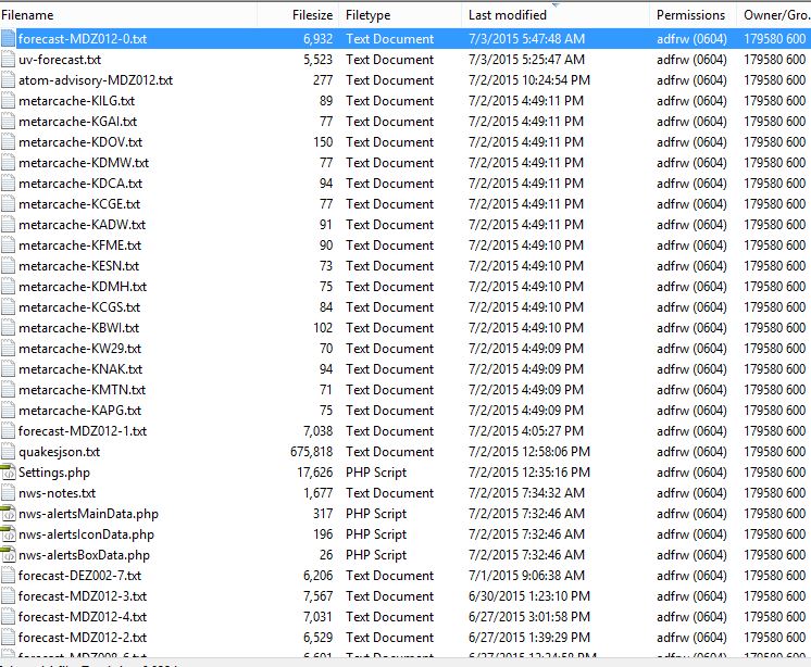

Dan, attached is what my cache folder looked like at around 5:45 AM this morning…
Steve

What is the content of your atom file?
