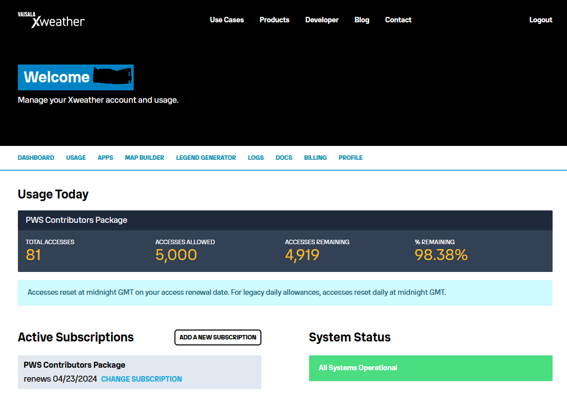

I managed to get in with the old e-mail/password: I selected product account Weather API first.
Note the bit about PWS Contributors Package and “legacy daily allowances”. . . might be a change coming here.
