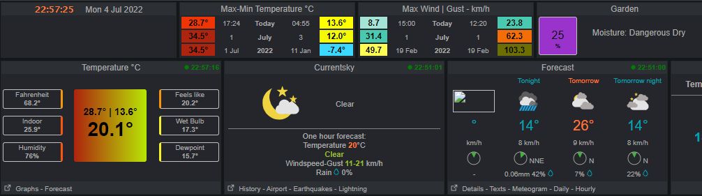

I had to transfer the PWS Dashboard website to another server. It seems simple and it’s just a matter of replacing the address of the page, but not everything is displayed correctly now. Advisory text and forecast icon are not loaded, there is an error in History_at_WU. Is it the fault of the hosting or there are some files I should still edit.

The problem with the display of advisory text and forecast icon occurs after around 4:00 p.m., when the forecast icon for the night, not today anymore, should be in the first position in the forecast.

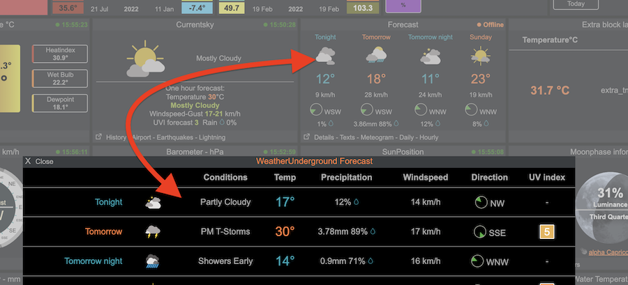

If you have this problem, please use the popup and make a screenshot, similar to the one attached.
