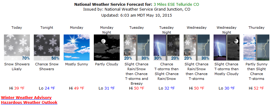

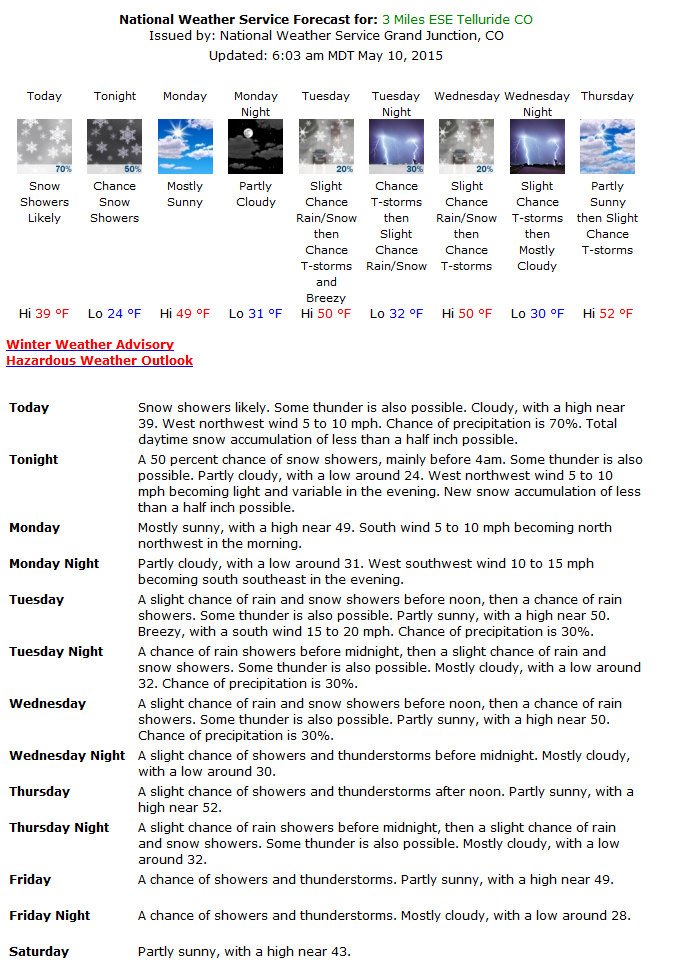

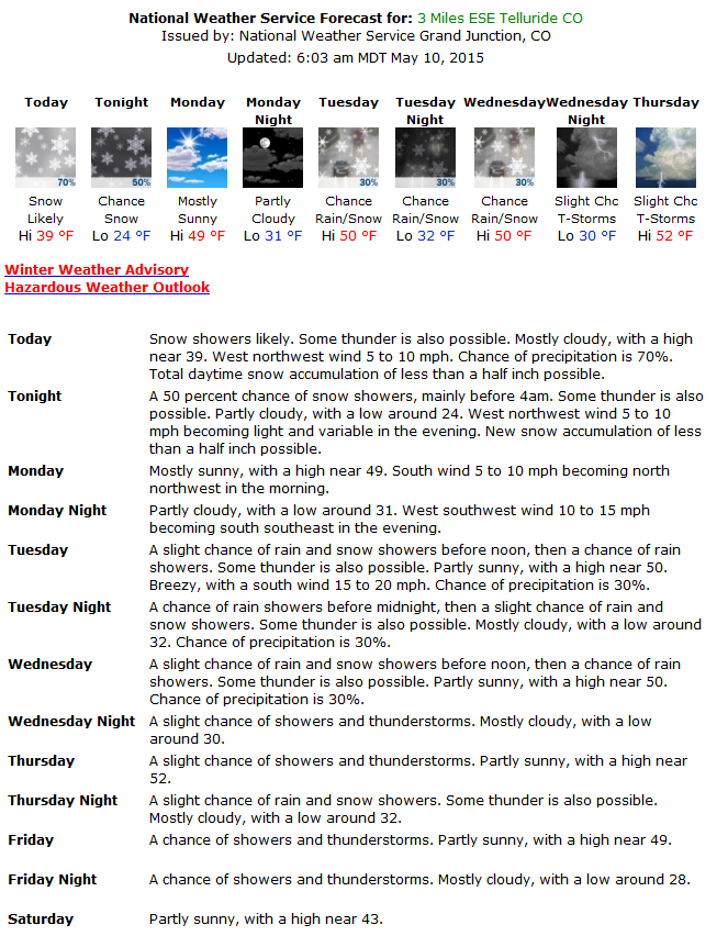

BTW… you may have noticed that the NWS site is offering a preview of a 6-hr split Icon forecast (where needed), and I’m already mostly finished with an advforecast2.php script that handles (and creates dynamically) dual-forecast icons when they appear. Also new sets of icons (jpg 55x55 and png 86x86) will be available with the V4.00 of the advforecast2.php script. I’ve attached some sample screens to show what it looks like.
