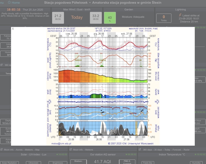

I managed to add another pop-up link in the WU block. I wanted to modify image_popup.php and exchange existing link with http://www.meteo.pl/um/metco/mgram_pict.php?ntype=0u&fdate=2020062312&row=402&col=203&lang=pl
I changed a name for ‘meteorogram_wu_popup’ and uploaded it. Unfortunately something went wrong. Something more is to modify.

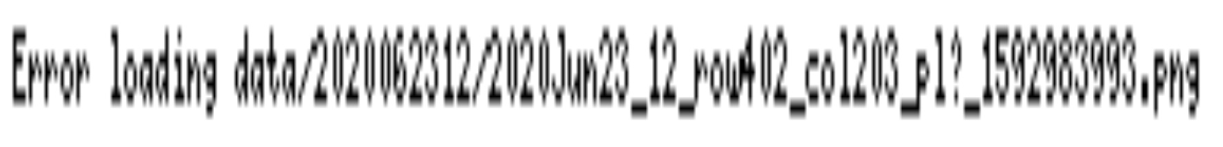

http://mark014.beep.pl/template/plugins/pwsWD/_test.php?test=meteorogram_wu_popup.php
Make the browser as low as possible, you can see an error message , see attachment
There are a few lines with a warning in the script

If you remove that # on the line, the image will display. This is not really an image, it is a PHP script which becomes confused when adding extra parameters.
Next problem. It also needs the date to be changed every day. Otherwise the image will always be the same, image of June 23.

Thanks for your help. Yes, in fact this link had a fixed date. Now the forecast image shows up. Is it possible to display it in an original size, which is 630x660 px?

Not easy to do. The dashboard is responsive and the popup size is fixed for all pop-ups and is adjusted for the screen size. The graphs is still shown on an smartphone.
One could display it so that it is not stretched, change the text background-size: 100% 100%; to background-size: contain;

Thanks, now the size is as I wished. I understand this and appreciate your help so far. I need to find time to figure out some details that are already my own modification.
