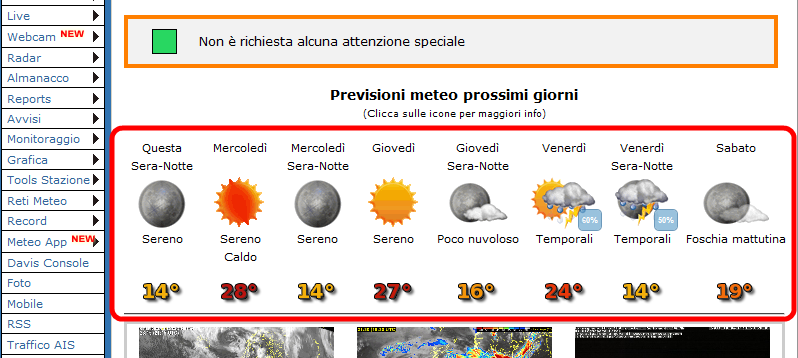

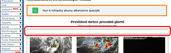

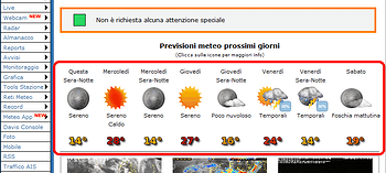

Hi to all,
anyone has icons problem with new plaintext-parser ver. 1.27?
I’ve attached two screenshots about it.
Alessandro

Hi Ken,
thanks for your reply.
I don’t still using the latest version of wxsin3in1.
I’m using the previous version.
The older version doesn’t have wxall.plaintext.php but it still uses your parser.

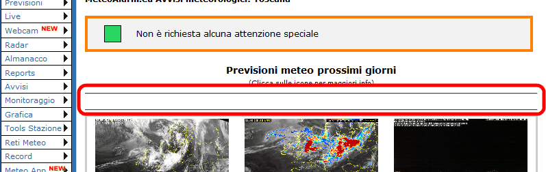

I don’t know why the newest parser causes this issue but i’ve linked others two images.
The first image shows my home with previous parser, the second image shows my home with latest parser.
That’s it.
Thanks in advance for any help,
Alessandro
Image nr. 1: http://Fiorentino.altervista.org/Cattura.PNG
Image nr. 2: http://Fiorentino.altervista.org/Cattura1.PNG

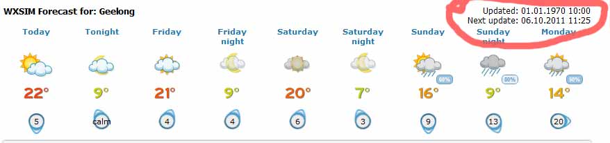

Hi Henkka
Fantastic script Thanks
Just have 1 small issue the updated time stamp on my output screen is 1970 see attach screen shot
http://www.geelongweather.com/sivu20.php
Trev
Hi Alessandro,
Unfortunately, the images can show the results of the problem, but are not helpful trying to diagnose what is causing the problem itself. As I said before, only the $iconType variable was added to plaintext-parser.php V1.27 – if the prior script by Henkka used a variable of that name ($iconType), then that is likely where the interference is coming from. You’ll need to scan the Henkka PHP code on your system looking for that … I can’t diagnose it from just a picture … sorry.
I did download your current (working) plaintext-parser.php V1.23 (a bit older) and compared it to the current V1.27 and found two items added just for your version of Henkka’s 3in1 script. I suggest you put
      ### ADD FOR 3in1
    $WXSIMwallText[$i] = $WXSIMtext[$i];
    ### END FOR 3in1
after lines 703-704 in the V1.27 script
	// put back translated text, fixing capitalization for sentence starts (except the first one).
    $WXSIMtext[$i] = preg_replace('!\.\s+([a-z])!es',"'.  ' . strtoupper('\\1')",$text);
and see if that fixes the issue.
