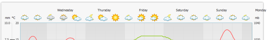

I have a slight problem with the alignment of the last day above the graph which I’ve not managed to solve yet (Monday in the attachment) … does anyone else see this ?
Kind Regards, Simon

That “Monday”-issue in the graph are because Flot likes to print the day soon as new day are present (00:00) and because text are centered are it is little off positioned at some forecastupdates. It will “reposition” itself in next forecast-update.
henkka
